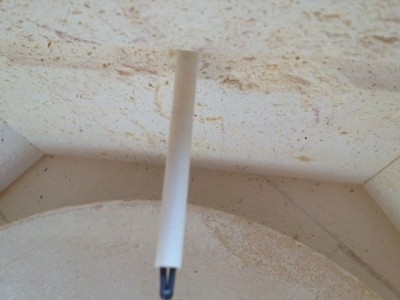

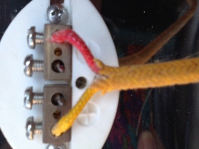

Hello,
I had a drop of glass land on it and replaced it. its just a small hotstart pro by skutt. The first 2 times the glass balled up (frit in a mold) at 1350/10 so i know its going way too hot. It was so easy to replace and im wondering if i did it wrong. I ordered it from skutt so i know its the right one. I have some small pieces to do and i hate using my larger kiln. Once i do some test firing is there a way to calibrate it? could it be installed wrong? If the two prongs are in the opposite holes they should would it make it fire VERY hot? I'm thinking it was close to 1600 to boil into the mold.
I should add, it does follow a schedule and come down - it just fuses too hot.
thank you
Sheree
thank you
Sheree

The leads are color coded. wire them up the same way they were. There should be a note on the controller for which goes where. Any Type K thermocouple should work. However all thermocouples are not created equal. If you can see the weld at the tip, you have a cheap, short life model. My personal recommendation is an inconel sheathed 1/8" diameter. I have been using a set of these, for over 20 years. I have noticed recently that I am not getting as much heatwork as I used to, considering the temperature I programmed. It is time to replace them. No big deal though. They are still working for me. I recommend buying from Krumor in Ohio. They are a primary manufacturer and will sell to you directly. Google them.

In my experience, if a thermocouple is connected backwards, the temperature reported will go down with increasing temperature, not up (granted, my experience is with dataloggers).
