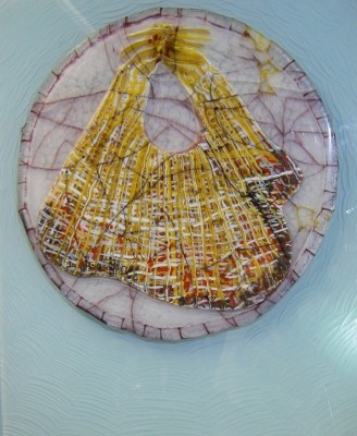

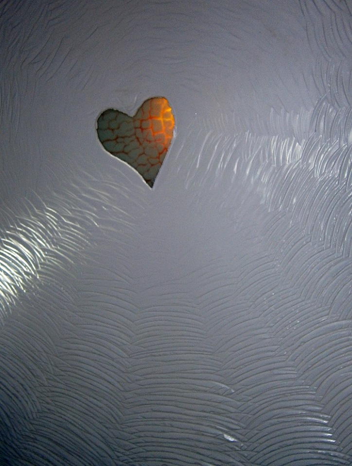

This piece is not quite in the right light in images shared. The segments around it have words in each one with the only one repeated is love. I deliberately smashed the piece to give a time worn look but had to laminate it onto laminated float because it stressed out on the cool down. Some things are meant to happen, I'm happy enough with the addition of float and the opportunity to add another dimension with the all the radiating carve marks from the heart, the Jesus thing going on works for me.
It was a mad scramble last year when I had my first exhibition, organised by self, never ever to happen again. So this piece is part of the exhibition that finalised all work during the naive stage. Trusting myself to get serious, finding my niches with bubbles and cane, even revisit dichroic for some. Hope you like it. peace, haydo
Crackle background piece.

Re: Crackle background piece.
love the heart one. what are you carving with? r.
A cheap coarse diamond wheel/disc for concrete finishing on pneumatic grinder with centre fed water. Due to mad rush I found that chips were easily created,
peace, haydo
peace, haydo
