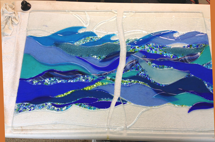

[attachment=0]Cracked glass 003.jpg[/attachment]
here is the pic. The crack just broke the piece, unaffected by design or shapes. The crack also has another crack about 4" from the bottom, making that triangle -( the visual "line" going off to the right is a just line of layered glass, not a crack).

AHA!!!! (BTW, this isn't a lengthwise split (in my book, anyway)...I'd call this a crosswise split. More on that in a minute.)Bonnie Rubinstein wrote: here is the pic. The crack just broke the piece, unaffected by design or shapes. The crack also has another crack about 4" from the bottom, making that triangle -( the visual "line" going off to the right is a just line of layered glass, not a crack).
What aspect ration are you referring to?
I was just about to do the even heating test (I have been cutting bricks for an hour to create the set up to do this!) I figure it can't hurt to do.
I can only vent my kiln on the top 2 'windows' and by lifting the lid. (bottom) Is there a way to safely create air flow with these?
I agree after reading tons of material, that it is the annealing. So, I am working on it.. but I sure do hear differing opinions from fusers, as well as Spectrum.
Thanks..!
When I look at this pic I see a bunch of coarse frit filling in the spaces between decorative components. I'm assuming they're attached to the base glass and also to each other and possibly the components on either side...right? Kinda like this, but different configuration:
http://www.morganica.com/bloggery/2007/ ... lotusbowl/
That bowl gave me fits because of the nice fritball/coarse frit decoration in the center. Each one of those components adheres to the glass when hot, then shrinks and tries to pull in from its fellows during cooldown. The potential for stress creation is tremendous, and I wound up giving LotusBowl one of the longer schedules I've ever given a fused piece--I think the schedule I wound up with was for 4.5X the actual thickness. The final bowl was extremely strong (until my niece's baseball hit it, anyway), but it took a lot of experimenting to get there. If I take the fritballs out of the center and just make this with flat glass, the schedule is MUCH shorter.
So...if I'm right, you've got a tack-fuse, a particularly complicated tack fuse because you have a LOT of pieces that need to stick together. The anneal isn't conservative enough. I'm thinking you START with a schedule intended for about 3X what you'd expect for a 3/8 inch piece, i.e., anneal for something closer to 1 or even 1 1/8 inches (27mm). That means you've got a 4-hour anneal soak, your next segment goes down at 27dph, then 54 dph, then finally 100dph.
I think it's being made worse by annealing on the floor of the kiln and if you elevate at least an inch it'll be easier to maintain thermal equilibrium. And since it cracked across the middle of the short length and is so close to the elements I'd also wonder if you don't have an issue with uneven contraction between upper and lower surfaces. If the glass is cooling a lot faster on the top center surface, it's also contracting faster. There's a chance that you're getting some additional stress in the center because it's contracting faster than the edges or the bottom, introducing more stress.
Normally I've only seen that break the piece when there's a much bigger distance in length vs. width, i.e., an aspect ratio of about 3:1, but I suppose it could be contributing additional stress.
So...either melt the glass into the surface more, so it's all one piece (even if it's "contoured"), or really extend your annealing schedule. If you've got access to a polarizing filter, try looking at a successful piece with it--I'll bet you'll see some stress.

Bonnie Rubinstein
Bonnie Rubinstein
- Posts: 239
- Location: River Falls, WI
Re: Continuing cracks- large glass! Why?
I read this on Bullseye website... in answer to a question posted re: breakage..
" it could be (most probably) that your kiln isn't even in heat across the entire span, making annealing of wide projects impossible.
if this is true, then longer anneal times actually work against you, as they freeze in the temp differences across the span, and only parts of it get annealed, leading to stress. shorter times may possibly work in this case."
so, there is the other viewpoint.
Bonnie Rubinstein
