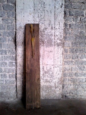

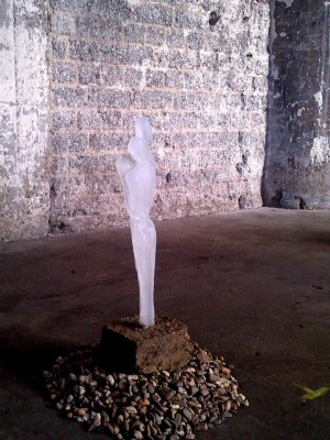

Here is the second one....
The photos were taken on the occasion of a show in a very old storage building.
