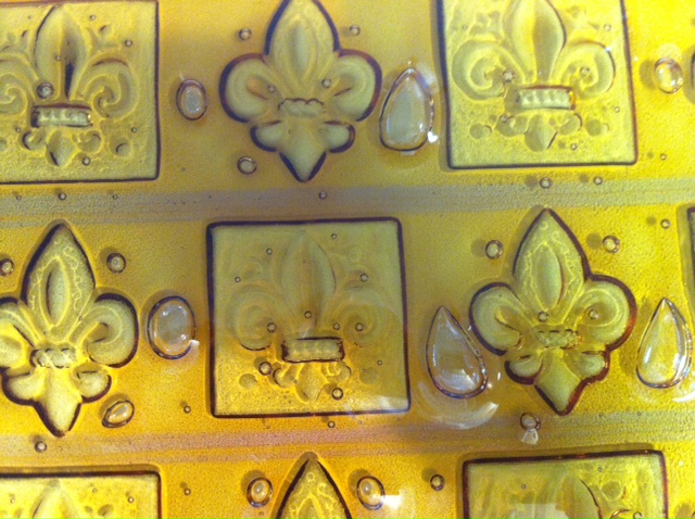

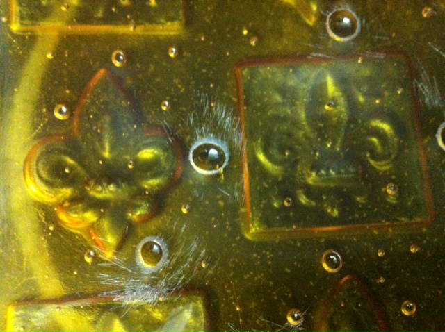

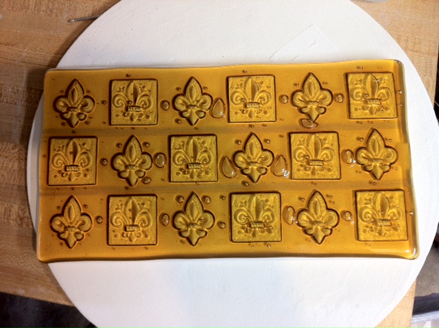

I'm relatively new to kill forming. I've got an art exhibit opening the Friday night and things coming out of the kiln have bubbles. I'm in a panic. Specifically, one texture mold in particular is creating lots of bubbles that when I slump the piece in a slump mold, they burst and make craters.
I'm using a Fleur d'Lis mold that is 7" X 13". I put a piece of Bullseye amber glass on the bottom, and have tried two different types of COE 90 clear glass on top. Both made bubbles, but the Uroboros glass (90 COE supposedly compatible with Bullseye) that a salesperson told me didn't make bubbles as badly as Bullseye clear made even larger bubbles. I think the texture tile is made by Creative Paradise, so I used their firing schedule below:

I'm thinking that the mold is the problem in that it has so many ups and downs - it is tiled with a number of raised fleur d'Lis'.
One other fusing onto a tile with patterns not nearly as high seemed to do fine.

Does anyone have any ideas as to what I could do to reduce or eliminate these large bubbles? Also, with the piece that has the bubbles that haven't popped into craters, should I drill them and hope that the glass slumps back into the craters while slumping on my slump mold?

Prefire the two pieces of glass together, using a full fuse schedule. If you don't already, add a bubble squeeze (30 minute hold on the way up) at around 1250F. You'll get small bubbles, randomly spaced.
Then put the pre-fired piece on the mold and fire again. No new bubbles, just the small ones, which shouldn't ruin the appearance of your final piece.

You'll get fewer bubbles using Bullseye's Tekta instead of Uroboros clear, which is machine rolled and very smooth.
The slight texture of the Tekta allows air to escape, resulting in fewer bubbles. I've got side-by-side comparisons which show larger, irregularly shaped bubbles with Uro and nice, tiny champagne bubbles with Tekta.

I would prefire the blank also, with the bubble squeeze. Depending on your kiln you might want to make it a little bit lower than 1250F (in my kiln, for example, 1250F is too hot, it needs to hold around 1230). I'd also slow down the upramp from about 1000 degrees on, to something like 150/200 dph, to give the glass a little more time to settle.
You're still liable to trap bubbles in that tile, especially if there are ridges or furrows between the rows (as it looks like there might be). Try a test with a prefired 6mm blank and see.
If you still get bubbles around the fleur-de-lys shapes, try chadding the corners. IOW, place small squares of glass right under the corners so that the glass is suspended about 3mm above the mold. When the glass softens on the upramp, it will drop at the point farthest from the chads (i.e., the center) and spread out towards the chads, pushing the air ahead as it goes. That will reduce bubbles. Try it, and see if it works better for you.
