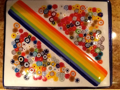

This is just a quickie iPad photo of 104 miliflori that I brought back from a trip to Italy. We went to Murano and I brought back about 20lbs of it! Anyway….This memory piece is on my kitchen counter. I fired it to 1410 and it came out perfect. I was happily surprised. I have also fired some beads to the same temp. Good luck….hope that helps.
