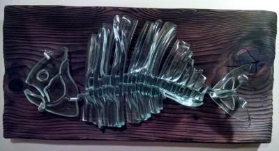

Helios Glass publishes an ebook of stands and mounting techniques that discusses the L-hook technique. The tip of the hook is visible, no getting around that, but surprisingly not distracting to the piece. in my experience.
This is the ebook:
Easy to Make Stands for Fused Glass
http://fusedglassbooks.com/
I did this piece that way:
[attachment=0]Fish_levels.jpg[/attachment]
I have no connection to Helios except appreciating their creative thinking and problem solving.
--SB
--SB

The fish looks great. I too have the ebook. Nice tip on the plastic dip too. Just for the record, I put the piece together with DP105 on an acrylic block and it is still hanging.
