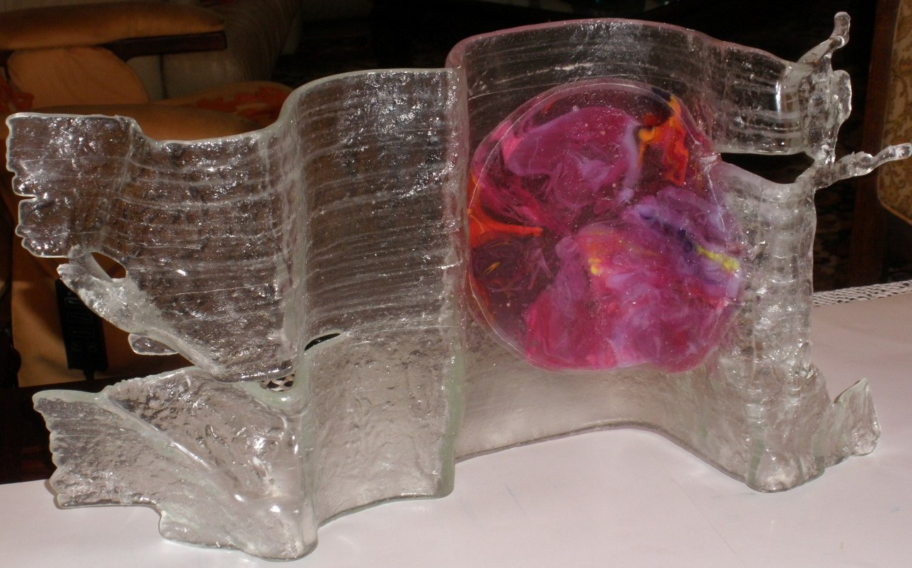

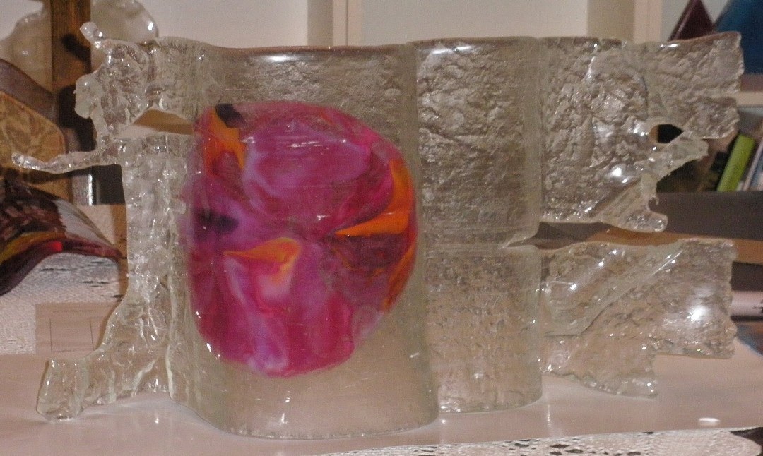

OK guys here is the final result, kilnformed. Without devit, without any dirt.
No marks of the horrible cracks this piece had. Unbelievable . Lucky I have photos to prove that it was broken, especially around the central image.
I used Spray A, diluted it first with regular water, applied very thin layer [I found out, the heavier layers become white thru firing]
I am posting 2 photos - of the face of the piece, and of its back.
I would appreciate suggestions / ideas as how to present it, OR links to where I would be able to look at ideas
many thanks,

I would like to mention that the white line you see at the back of the piece is not a crack or a score . IT is what was the end of the mesh melt before. Under the heat and the weight of the clear glass, it spread , but it kept the previous 'border' of the melt. Perhaps had I sandblasted it - I would have been able to prevent this.
