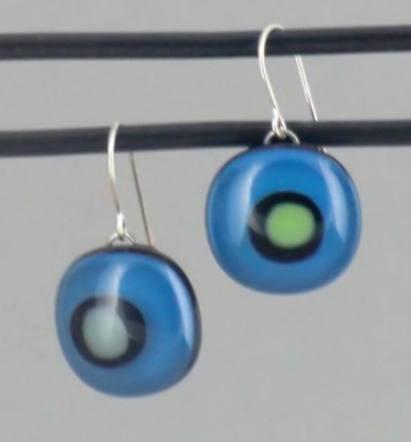

I often see people making earrings and they either have small bails glued onto them or some of them use some kind of small ring at the very top of the earring. I know I can buy small bails and glue so I am interested in the small rings that seem to be in the earring itself, and not glued on.
I tried using an eye-pin and cut it down to match my glass size but the earrings that were transparent showed some of the long part of the pin. I also did not use stainless steel eye pins but nickel ones and they disenegrated in the kiln.
So I am looking to use some tiny jump rings but not sure how I would get them to stay in the glass.

There are tiny rings coming out the glass itself. Is that simply a stainless steel jump ring?

I would think that any jump ring you use in transparent glass earring would show. I used some under dichro on clear and that's what happened. I didn't like the look.
I use .999 fine silver to make rings. Off hand I can't remember the gauge but I'd guess 18 or 20. I get it at my glass supplier. It fires and turns black but shines up very nicely after firing and stays that way. I just use round nose pliers to make a ring and fire between two layers with the top peeking out, of course. You can use a bit of 1/4 or 1/8 inch fiber paper to prop it up if it looks like the ring won't stay in place.

I forgot to say that many folks have had trouble using fine silver in their kilns. They say it can leave ugly marks on pieces in subsequent firings. They recommend using a shelf dedicated to using silver. I don't do that since I've never had a problem. But lots of people have warned against it so i thought I'd mention it. Who knows, next time I could have a problem.

But doesn't the fine silver wire show as well if you are using it with transparent? Or do you just use it with opal or blacked back dicro only?
Thanks for the heads up about the silver. I have heard about that but was thinking it only applied in terms of silver foil. Did not even think about silver wire in the kiln.

Just use some high temp wire. It "tarnishes" when fired, but can be cleaned up fairly easily.
But if you are trying to use it on transparent glass, yes, any kind of bail or wire is going to show (except for glass bails).
