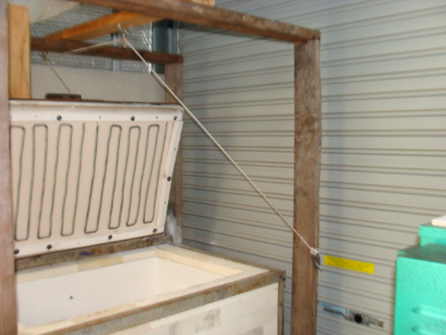

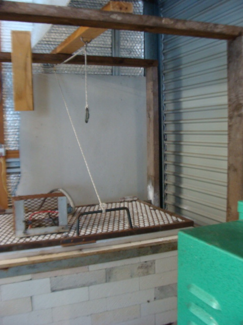

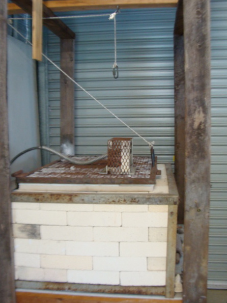

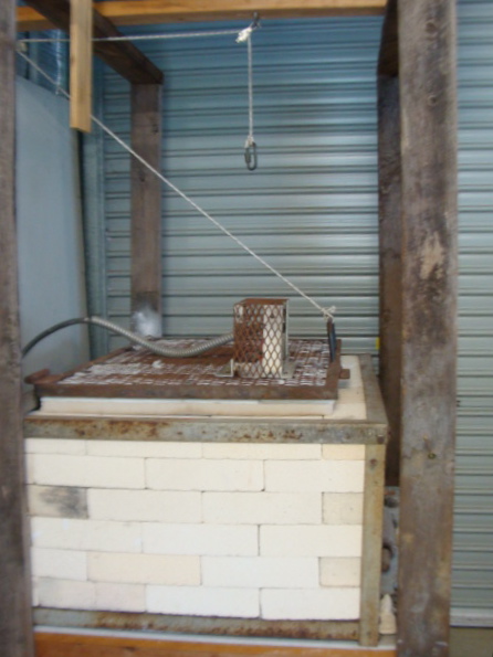

My brick kiln has a home-made lid-lifting device, super simple, some 2x4's, rope and a pulley. It's not pretty but it's functional and requires minimal effort. Hooking a loop in the rope over a nail in the framework holds the lid open. It is operated by standing in front of the kiln. This kiln is now in a corner so access is only possible from the front and one side.
It started out with a counter-weight but that went down behind the kiln and collided with the thermocouple. The lid is not so heavy as to need a counterweight so that was abandoned.
The kiln is on a wood stand on castors with a sheet of cement board under the kiln. The 2x4 framework for the lifting device is attached to the wood stand.
If you'd like a pic I'll take one and post it. Jen

Buttercup wrote:My brick kiln has a home-made lid-lifting device

Jim, as requested, here are the pics of the very low-tech kiln lid lift-assist. Hope that helps, Jen
Posts: 626
Re: need help deciding on which large kiln
Tried to add to the message after I'd added the pics but couldn't. (Told you I was strictly low-tech.) Anyway, just wanted to say that the cover for the electrical box on the lid is temporarily off. Don't operate like this at home. It just had the fibreboard in the lid replaced and the elements reinstalled.
The framework was hastily erected from material we had around, 2x4's from concrete forming. The short vertical board is there to stop the lid going right back and smacking into the sending unit which is mounted on the wall behind the kiln. If I want to quickly peek in then I just raise it enough to see in without fully opening it. Hope that helps.Jen

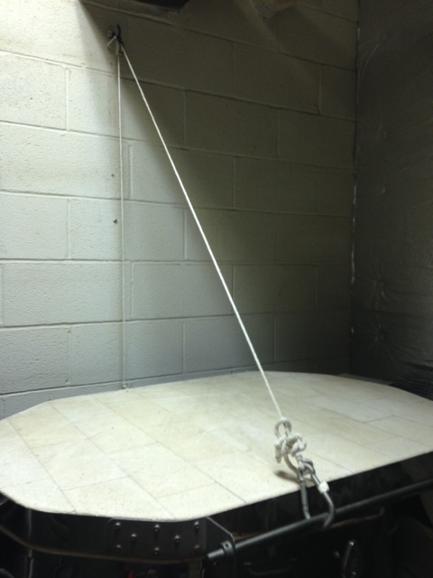

Jen, here is a photo of the counterweight system i made for my oval kiln. The weights were old gym weights with some sand to get the perfect balance. Very simple and very effective.

Very tidy! I'd have preferred not to have the wood frame but it was necessary because my workshop is corrugated metal so putting a hole through the wall is not a good idea. Also, the kiln will eventually be repositioned when the workshop is extended so the frame can go with it. The walls will still be metal. There currently isn't room to pull the kiln forward enough to make room for a counterweight that won't interfere with the thermocouple. In the last workshop the rope went up to a low beam. Jen

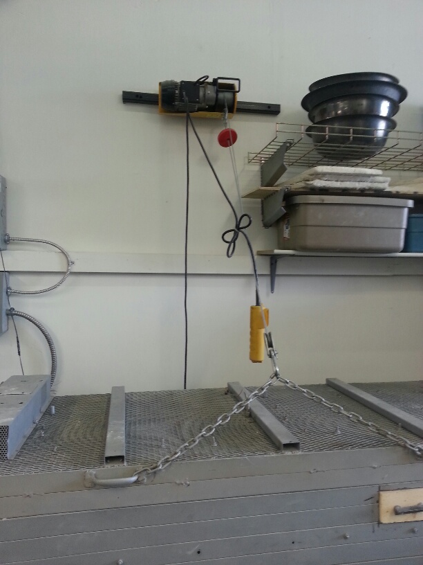

I tried a counter weight system once but found it too finicky. So I bought a hoist
Much easier to get the lid an inch or a foot up.
