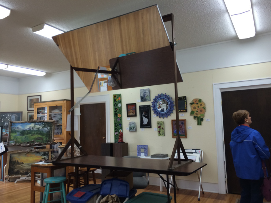

For a teaching studio, I think it's essential to have some way to give students a close-up of what you're doing. It's not a problem for 3-4 students; they can crowd around the table and watch. But if you're going to have more than that, it'd be good to have either an overhead mirror or a video camera focused on your worktable with a large panel TV on the wall, so that students can stay in place and still watch your hands. We did the video solution for one class I set up awhile back, and were able to accommodate more than 30 students.
Was at the coast this weekend and talked with an artist's coop there; they made their own mirror and said it was quite effective: The other stuff you're more likely to advise ME about, than the other way round. I'd love to see your studio plans when you're done.
