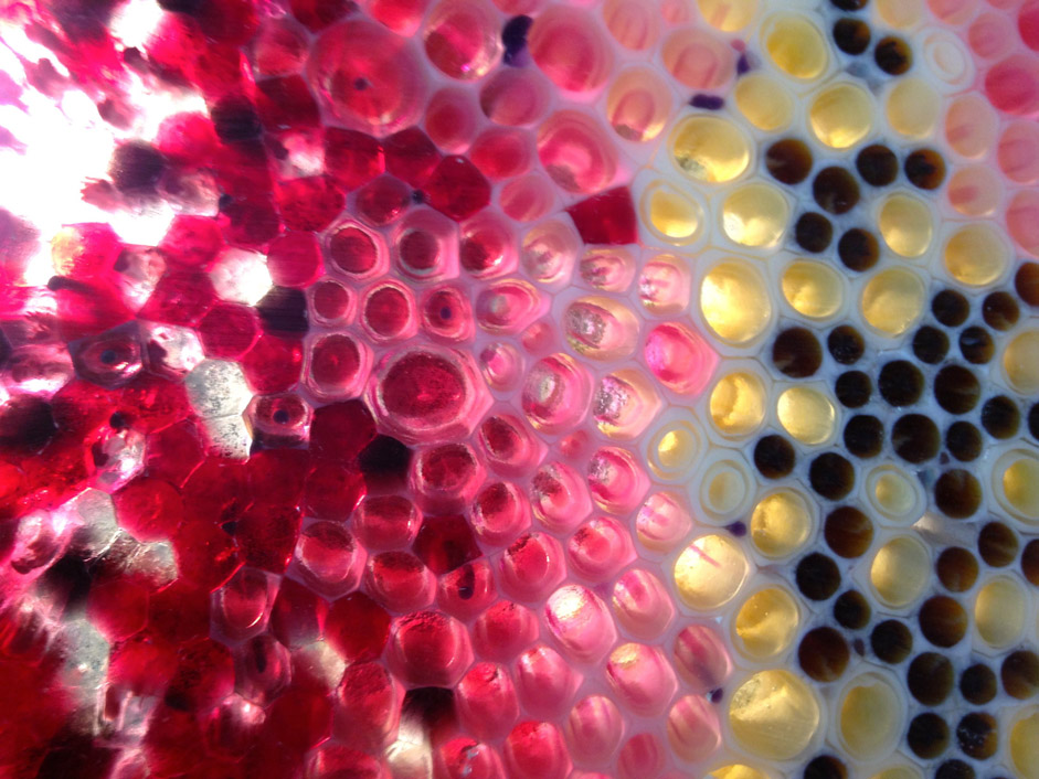

You mean like this?

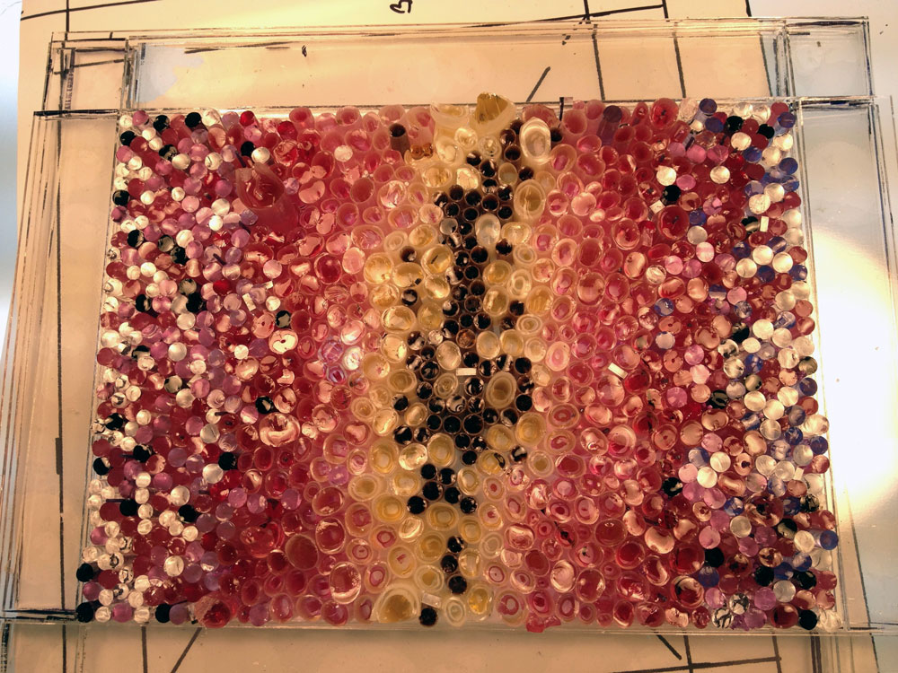

That's done by snipping a whole bunch of fusing rod and pulled cane "vitrigraph stringer," piling it into a dam and flat-fusing it. I typically compress it instead of dam it, so that I get a thinner-than-6mm piece that's perfectly flat and easily cut.
Not really a rondel, but I like the dimensional qualities. They'd make a cool addition to stained glass.

That's an interesting technique, Cynthia. Are the bits of rod and cane set on a thin piece of clear sheet before firing to create the clear spaces around the colors?
Re: Lamp worked rondels and other 2D forms
You can (and I've done it that way), but typically not--the pieces you chop are generally longer than 6mm, so they're going to spread and fill in the gaps anyway. If you do make them shorter than 6mm, then yep, you'd want to have a base or something to fill in the holes.
This piece was used to make a roll-up--where you give the panel to a glassblower to turn into a vessel--so the pieces were about 10-11mm long. You need the thicker panel to give the gaffer room to expand it. So the base glass wasn't needed at all.

Cynthia, to go back a few posts--how do you press the snipped bits of stringer, instead of putting it into a mold? I'd like to work with some of this technique, but I'd like it as thin and as easy to cut as possible. Thanks! Kate
Kate Saunders wrote:Cynthia, to go back a few posts--how do you press the snipped bits of stringer, instead of putting it into a mold? I'd like to work with some of this technique, but I'd like it as thin and as easy to cut as possible. Thanks! Kate
You lost me there...press the snipped bits of stringer? You mean, do this same thing but with stringer?
Actually, the cane isn't that difficult to cut up to about 3/8 inch in diameter. Much bigger than that, and I get an old mosaic nipper and a hammer. But if you've got a lot of uniformly sized stringer or noodles, you can tape them together like a mini-blind, then hold the sheet down and score across it a few times. Once you've done that you can usually break them apart pretty uniformly. I've got some photos of it in a murrini blogpost:
http://www.morganica.com/glass/fusing/m ... ellyrolls/
I haven't tried that with more than one or two rod at a time; be interesting to see if that works.
It's a pain in the neck to arrange a bunch of (probably jagged-bottomed) stringer or rod or cane--they want to fall over. I typically cut some strips of scrap about a half-inch wide, interleave them to make a frame that's slightly thinner than the length of the pieces. Then I stand the kilnshelf I'm firing on at about a 45-degree angle, rest the glass frame on that, and start filling it up with cut pieces.
Doing it that way lets gravity do most of the work. I can just stick the shelf, frame and all, in the kiln without jostling things around. I usually lay another kilnshelf on top and weight it down so I get a perfectly flat blank.
Is that what you meant?
