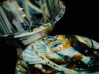

Well I have been having a wonderful time experimenting with Reactive Glass of late and created a large thick colour bar that I sliced up ( sad to say my saw pump finally quite on me
) but could not waite so hooked up a hose and kept on going) Anyways, really excited to try a deep slump vessel that is totally different from inside outside. I am really excited also to create a large cast piece that will slump in a large mold at my friends place in Elkford , B.C. Can hardly waite for that. But for now , here is the beginning of the deep slump piece. Do not usually like to use fiber but did not have the right Zircar mold so here goes nothing

Well patience is a friend today . I am happy with the very different look from inside to outside and the reactions are strong. BUT I love the gold and silver side.

I thought I would create a really large deep slump mold for a large vessel form I am working on. I could find some nice large slumping molds out of ceramic but not this deep so thought I would make a mold mix 6 one. Creating it over metal is perhaps alittle tricky as the MM6 wants to shrink while drying , but I just had to keep putting on layers and if a slip came up , just painted on more MM6. So will see how it comes off the mold . 24 inchs wide by 12 inchs deep. An old wonderful metal shape dear Patty Gray had given me many years ago. Always kept it because \I loved the shape. Mind you here it looks alittle like a helmet but it won't when it is finished.

The lovely larger mold is from " BLUE FIRE MOLDS " one of the sponsors here. It is only 22" inchs wide though so I have a larger ring on lay on top of it to slump bigger pieces. I also make the birds nests in it with fiber so I can put a 20 inch square on it and let it slump into it that way. The bell shaped one is only 20 inchs and from Bullseye. Nice bell but not big enough for me. I am going to slump my flat fired piece all in one as I do not care if it tips abit as that is exactly what I love . Sits so different and you can really see inside the glass vessel when done and no one piece will ever be the same which I love. BUT if you want it to slump perfect then I suggest the 2 slumps. I did create the deep ( metal mold) to be tapered on edge by putting plastercine around the edges for a nice gentle slope for the glass panel to sit on.) I will hope to slump in a week so will keep you posted. BUT check out the BLUE FIRE MOLDS.
