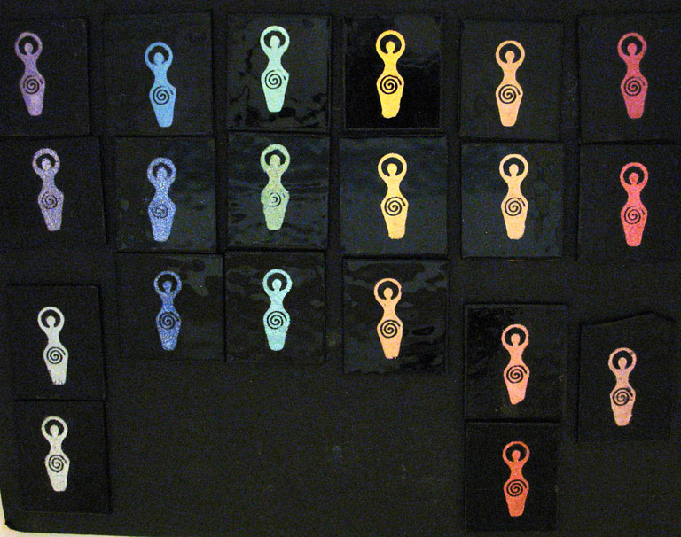

There is no chemical bond between mica and glass. It is strictly a physical bond. The mica sinks into the glass surface (thanks to gravity) and is held in place. Softer glass, better adhesion.
There are other variables also. The larger the particle size of the mica, more it sinks in (weight of the particle). Another factor is the coloring agent. Blue and purple agents do not withstand heat as well as the metallics (and to some degree green).
Having said all that, the best way to determine your situation is to experiment, both with the glass you intend to use and the mica.
Oh, one other thing. There is no such thing as standard mica. We are experimenting with micas right now and I can assure you there are literally hundreds of micas in every color.
Will be doing a blog soon on the experiments.
Here is one run:

Hey Barry, are those samples pre- or post-firing?
They look great!

The samples are post firing. Below are samples of micas after a second -full fuse-firing. Held color pretty well.
Secret is two-fold.
First, we have found a supplier for the blues, purples and greens who services uses other than cosmetics. They still have some problems, but survive far better than what we found previously. We will be integrating them into our micas for sale.
Second, we apply the micas onto screen printed (and still wet) Kaiser Glass Paints of colors similar to the mica. We use blue base for blue, purple and sometimes green.
Still have problems with capped micas, but less so than in the past.
