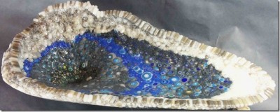

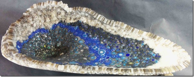

When I first started to work with glass in '97 I made a slump mold with Mold mix 6 in what I thought was an interesting shape, like an ancient Egyptian oil lamp. Little did I know then that it was an impossible shape to slump, which I confirmed many years later using window glass. It looked possible to use that mold to stack vitrograph murrini along the walls and tack fuse at 1385. The result is below. If I were to do it again I would tack fuse at a lower temp. like 1350.

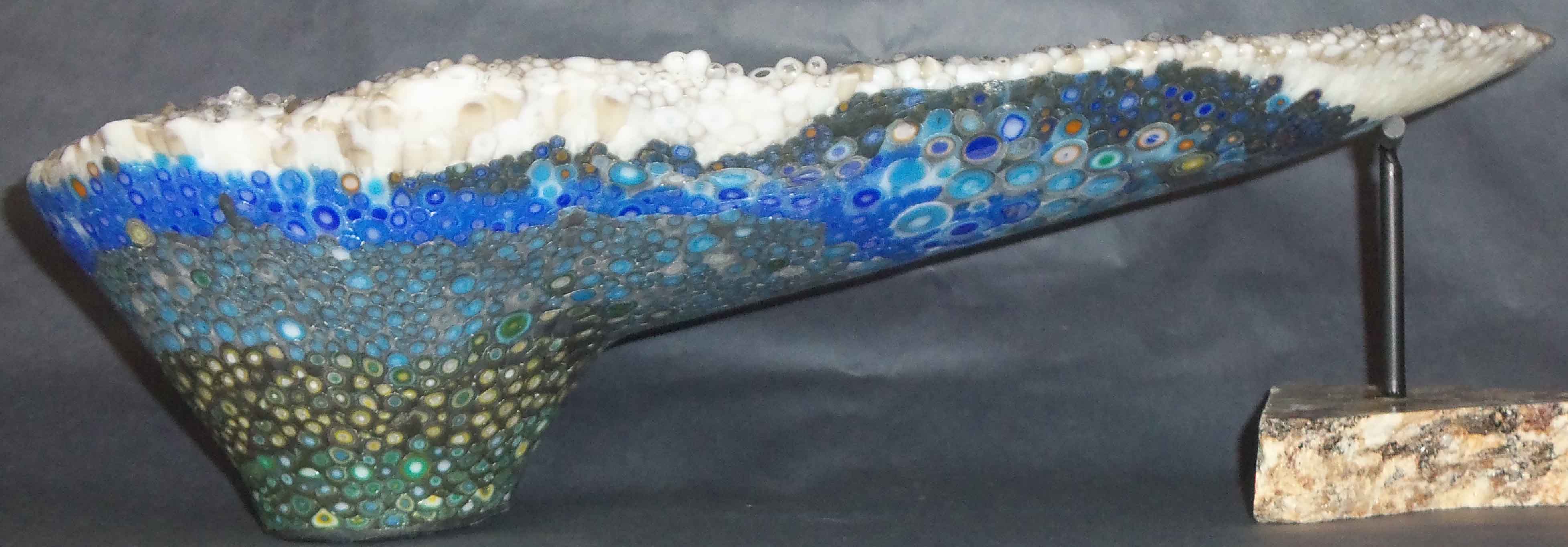

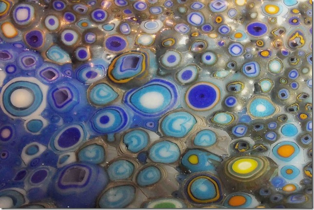

Two more photos of Warren's piece:

The colors, textures, and form are beautifully organic. Could you have tack fused flat, at 1350°F (+/-), and then slumped into the mold at 1250°F (+/-)?
Michele,
That shape is impossible to slump into. It has a deep foot at one end. Glass will fold up on itself as it slumps. Tried it with window glass first and it folded up. I actually had to fire the murrini 3 times. After the first fire the sides settled down as the air space disappeared between the individual murrini and I added more rows to top up. Had to do that a second time for a total of 3 firings.
