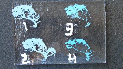

I dug out my (Gare brand) ceramic stuff and discovered they were dried out. I chose an opaque underglaze, scraped a small amount off the chunk and onto a glazed tile where I ground it into a powder. I added a drop of liquid stringer and worked it into a paste which I then smoothed through a part of the screen I had onto clear glass. Came out just like the video. I then did a similar test with Paradise and Fusemaster opaque but added a bit of dry gum arabic as well as a drop of liquid stringer. Looking back, I should not have introduced a second variable (gum arabic) but oh well..... The underglaze went through the screen just fine. The two enamel results were not as good. The screen is extremely fine and that could have made the difference. Samples 1, 2 are underglaze. 3 is Paradise and 4 is Fusemaster. The sample is unfired. I'd say the fault in 3 and 4 is operator error. The gum arabic may have caused drying too fast. I haven't fired the test because home renovation has cut off kiln access.
Re: low tech screening
I believe liquid stringer is CMC which is a binder, itself. Too much gum always causes problems.Vonon wrote:I dug out my (Gare brand) ceramic stuff and discovered they were dried out. I chose an opaque underglaze, scraped a small amount off the chunk and onto a glazed tile where I ground it into a powder. I added a drop of liquid stringer and worked it into a paste which I then smoothed through a part of the screen I had onto clear glass. Came out just like the video. I then did a similar test with Paradise and Fusemaster opaque but added a bit of dry gum arabic as well as a drop of liquid stringer. Looking back, I should not have introduced a second variable (gum arabic) but oh well..... The underglaze went through the screen just fine. The two enamel results were not as good. The screen is extremely fine and that could have made the difference. Samples 1, 2 are underglaze. 3 is Paradise and 4 is Fusemaster. The sample is unfired. I'd say the fault in 3 and 4 is operator error. The gum arabic may have caused drying too fast. I haven't fired the test because home renovation has cut off kiln access.

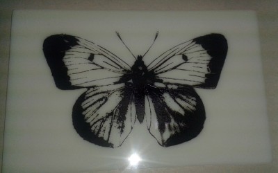

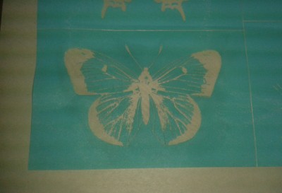

I bought a martha steward silk screen from ebay to play around with it:
I then mixed some black ferro enamel with A14 until it was a little runny and then added a pinch of cmc powder until it became thick like frosting.
I wore a latex glove and pushed the "black frosting" through the screen with my fingers. This is what I got:
I will fire it soon and let you know how it goes.
Pete
Pete
