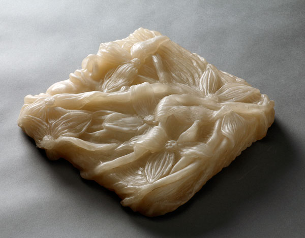

I don't know that I have the definitive answers to any of these. Is it temporary? Dunno; I first applied Clear Shield to a pate de verre casting in 2007 and it's still on there so it lasts at least 8 years. It WILL start out fairly glossy when applied (till you buff it down), and then at about the 2-3 month mark settle in to a low-satin finish. By the second or third year there's not a lot of shine left, but right now those pieces are still smooth and sealed-looking.
I'm pretty sure that if someone regularly cleaned the piece with solvents you could remove or damage the sealant and mess with the appearance of the surface, so I'd opt for making sure that buyers received a disclosure and some care instructions...as is the practice with many bronze and stone sculptors. I've worked with quite a few over the years and all of them use surface coatings like these all or part of the time:

First...the idea that patinas don't change over time is nonsense. Certainly the ones I own have changed,* as have paintings, pastel and graphite drawings, sterling, wood, and ceramic art...and even glass. Art evolves, that's part of its purpose.
And Marty's right: Wherever did I equate Clear Shield to patina on bronze? What I said was "protective wax on bronze or wood."
It certainly isn't unusual to purchase wooden, ceramic, or metal sculpture (or even jewelry) and have the artist recommend that you periodically apply some kind of oil, wax, or sealant, or take some action to preserve the original surface appearance. I don't have a problem recommending that someone do the same when I sell a piece of pate de verre sculpture.
BTW, Dick, my hand-finishing process takes four or five times longer and a lot more effort than it would to "achieve a good look and feel by coldworking a little bit," so I'm not proposing it as a lazy substitute for getting in there with a big ol' wet belt sander. However, I do get "caught up in the response that it looks good or feels good."
It's bloody near impossible to achieve the same surface quality without handwork, especially not with the level of detail I tend to put into my sculptures. I've spent the last decade trying to figure out a faster, easier way to achieve that same surface quality using machine polishing, fire polishing, etc. Problem is, I dislike the more artificial-looking surface those (faster) techniques impart. I much prefer the softer, hand-rubbed, hand-oiled finish, so I put in the extra time, and disclose.
I have, in fact, just about figured out how to build a polishing machine to do pretty much what I want on a fairly large scale, but the quote I've got back is expensive, it's going to be very noisy, and probably not cost-effective. And it will STILL look best with an oiled or sealed finish.
