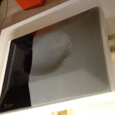

My slump resulted in a raised hump and am not sure if it is the beginning of large bubble or if the glass just did not slump long enough. I need help understanding how I can best try to fix this piece and also avoid the problem for future projects.
I am using a JenKen fiber square kiln with top heating elements.
O The mold is approximately 11.5 x 9.25 x .6.
The glass I am using: Uroboros radium clear over Bullseye elephant grey and Bullseye black opalescent with silver irid. The original fusing of the piece was very nice.

The top side shows the raised hump (it looks like there's a bubble forming on the right side of the hump, but that is just photo glare).

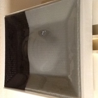

The underside shows a bit of a ragged edge forming around the hump.

looks like your mold did not have a vent hole in it!!
Re: Need help with Creative Ceramics medium rectangle mold
Have to agree with Don. Without seeing your mold, it appears that as the glass slumped, it trapped air which caused the bubble.

There are 2 unblocked vent holes on the base of the mold in opposite corners. Should I risk drilling a few more holes? I would hate damaging this new mold.DonMcClennen wrote:looks like your mold did not have a vent hole in it!!

Is there a way to determine that this is a bubble rather than glass that did not slump?Valerie Adams wrote:Have to agree with Don. Without seeing your mold, it appears that as the glass slumped, it trapped air which caused the bubble.

When I have seen "humps" or bubbles during slumping, it has been because of too much heat work. So that's either too high of temperature or too long of a hold. In your case, I wonder if it is a little of both (especially if you kiln runs "hot"). That is why I recommend dropping the slump temp and shortening the slump's hold, but lengthening the hold at 1100.
At 1100 and a 40 minute hold, you may find that the piece is completely slumped at the end or at least pretty close to being completely slumped and the 10 minutes at 1225 will finish it off.

Could it have somehow slumped into the corners first, before center touched down, and thereby trapped air in the center? It wouldn't hurt to drill a 3/32" hole in the center, would it?

As it nears the target temp it is essential that you peek. Many times the slump is complete and needs no hold.
If you hold for a time after the slump is complete it can blow a bubble even though the air has escaped at the corners. There can still be a tiny amount in the center. Given time that can grow into a nice bubble.

In my view that bubble has to do with too high a temperature and too long a soak. Holes are not the problem, the distance from the floor or the elements is not the problem.
The problems relate to too high a temperature. this shape can be slumped at 630C in 20mins. Higher and longer allows the glass to move, but it is not fully plastic, so instead of becoming thicker, the glass rises at some point like a bubble. The fact that you have needles on the bottom is another indication that the firing is too hot. The second problem is that you did not observe what the glass was doing in the mould. Had you done so, you could stop the firing and advance to the annealing segment.

Thought I would provide an update to close the loop on my original question.Deive Butvila wrote:My slump resulted in a raised hump and am not sure if it is the beginning of large bubble or if the glass just did not slump long enough. I need help understanding how I can best try to fix this piece and also avoid the problem for future projects.
In order to 'fix' the bubble, I tried the following slump temps with very little result:
1200 hold 45 - no change to bubble
1220 hold 30 - no change to bubble
1225 hold 1hr 15 min - slight improvement
1225 hold 1hr 30 min - still only slight improvement
I finally took the bull by the horns so to speak and drilled a hole in the middle of the mold. The result is that I got a perfectly slumped plate in just 15 minutes at 1225!
Lesson learned - watch the slumping process to avoid the problem I created for myself in the first! Perhaps I would not have needed to drill another hole in the manufactured mold except for the fact that I had an obstinate bubble to bring down.
