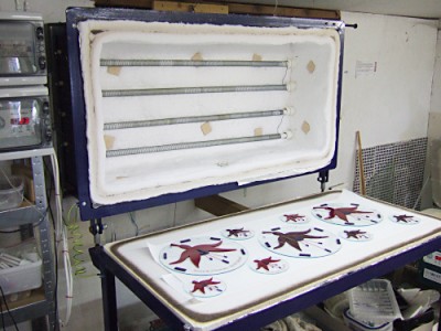

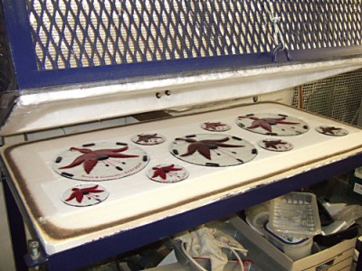

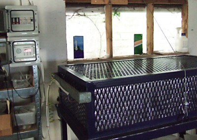

HI MartyMarty wrote:Adrian- Now you have to post photos!
You said clamshell- lifting the top a little to peek won't lose much heat...
Don't know if this'll work...? <edit - looks like it did!>
Shows the general look of the kin. There's a pulley & counterweight system to make it easier to raise/lower the clamshell.
The large round fuchsia suncatchers are about 12" diameter.
I know that lifting the lid for a peek won't make that all that much difference - but you know what it's like - the desire to improve! <g>
Thanks
Adrian
