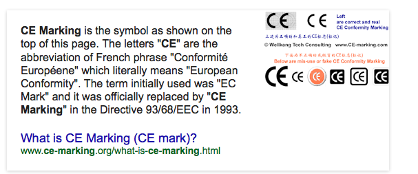

On viewing the site I see this:
The internationally accepted meaning of this symbol is this: When challenged Chinese exporters say it means 'Chinese Export.'
