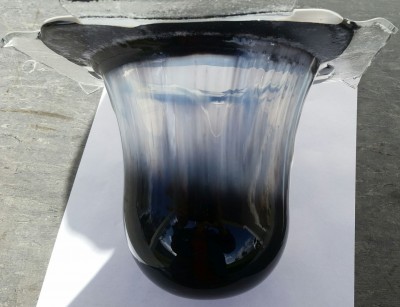

Hi,
I am trying to make a black/white drop vase as a gift.
The blank is 4 layers of 3mm BE glass, 5" square, starting on the shelf:
Tekta clear
white
tekta clear
alternating strips of black and white.
Fully fused to 804C 1480F. Due to the full fuse and no dams the blank spread out to 6 1/4" (this is ok, I am experimenting and learning).
Had intented to drop 6" using BE smallest mold (8633, inside diameter 3" 8cm). However, because the blank got a bit too big, decided to use the next size ring, 8632, ID 4.9" 13cm.
Reduced height to 5" props.
Added 1 1/4" wide strips of tekta around the blank, to avoid it falling into the mold. As mentioned before, I am learning so was not sure if the blank was wide enough to stay in place.
Blank placed on the mold with the top - the black and white strips layer - now towards the bottom, so it becomes the outside of the vase. The mold covered with a ring of fibre paper with the whole cut 1/8" wider than the inner diameter of the mold.
Don't know if this is really necessary, I get a bit of a rough surface on the outside of vase and wonder if this is from the 2mm fibre paper. Had used it once before (in another failed attempt at a vase). Saw in the BE video that they disposed of the fibre paper ring after one firing. Thought it wasteful, but may be it is necessary to replace it for every firing.
It took 4 1/2 hours to touch bottom. I hold at 680C 1256F until it is ready.

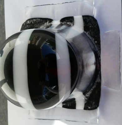

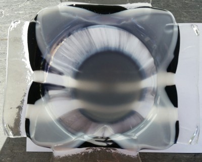

As you can see in these pictures, there is still enough of the colored blank remaining on the flat rim (to be cut off). I thought this should have been enough reservoir of color to get more intense black and white from rim to bottom, but the top half of the vase is very diluted and transparent.
Have seen in the BE video that the glass stretches more towards the edges (close to the mold), and very little in the center. But all my research on the web seems to show that blanks are normally fused from 4 or 5 even size squares of glass (not by piling little extra strips of colored glass around the area corresponding to the inside rim of the mold)
My question is: how do I get enough color density on the top half of the vase? I really have no idea how to move forward from here.
Amanda Simmons is coming to Australia next year, I have registered for her class but that's 12 months to wait. Would love to be able to make this wedding anniversary gift (to be posted in September).
Many thanks,
seachange

too fast a firing would be my first guess.
That is why the bowls that are steep sided are fired with 3 different molds over 3 different firings.
The other way would be to get the magic temperature in your kiln that will allow it to move downwards but only slowly.
Or much simpler, drape the piece over a mold and then deal with the folds and the usual problems of the base not being perfectly flat.
Then you have the choices of lapping it flat and or gluing on a base.
Not only have you got no colour, you have super thin glass on the sides.....
Use stiff black perhaps but then you could have issues with the white's viscosity and compatibility.
I used to make 20" vases but they needed a stand.
