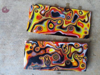

If it will upload, this is an example of what I'm doing.
- Posts: 381
- Location: Ontario
Re: Cutting Very Thick Glass Slabs
Sorry Don, we miscommunicated. I said in the initial post it was 3"x10" long. The block is 3" thick.

Yeah, I'd doing pattern bars (see pics above).
