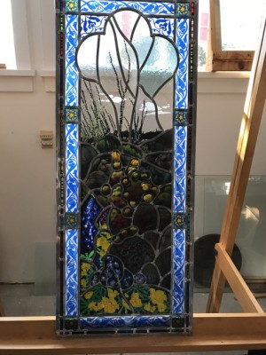

Post by Don Burt »
Some bullseye tack fusing and carving in the flowers.
linn keller
Posts: 52
Location: south tx
Re: glass I'm working on
Post by linn keller »
don,
gorgeous!
is it for you or some lucky other?
thanks for posting pics; always a treat to see what you're working on.
linn
linn in deep deep south texas
Posts: 774
Post by Kevin Midgley »
Beautiful =D>
The panel edges are they etched flashed glass?
They are spectacular.
Posts: 197
Post by Vonon »
Spectacular is the word! Your work is unlike any other and I'm impressed by the ever increasing degree of difficulty. I was waiting for a sun catcher photo but this is so much more satisfying! =D>
Don Burt
Posts: 580
Post by Don Burt »
Thank you for the compliments. Those blue on white border pieces are screen printed enamels on float glass, sandblasted on the back. Its the biggest single installation I've ever attempted. Got a long way to go. Fun though.

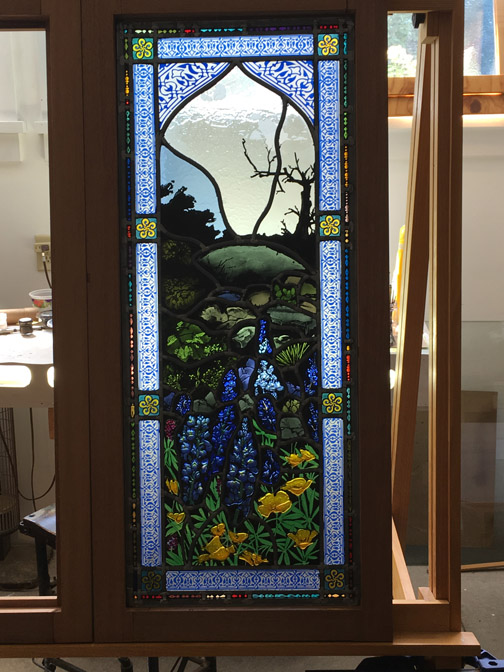

Thank you. Making slow progress here on the project. Two of the eventual four sections are pretty much complete. The arched sections will actually be on top, with the square panels on the bottom, in the eventual setting.
Posts: 638
I'm running out of superlatives here, Don. Is the blue enamel R&G transparent? It's so intense, not wishy-washy at all. Is it the sandblasting on the back that contributes to the intensity? I can get reasonable results on white but on clear glass the effect is pretty blah. I don't have R&G enamels though, because of the lifetime-supply minimum quantities.
Are you sandblasting before firing so the etched glass gets a fire-polish as well? They are gorgeous whatever you're doing! Jen
Like the ones before me, I run out of words.
This is so very beautiful - - -
Good for you!
Many thanks for sharing!
Don Burt
Posts: 580
Post by Don Burt »
Thank you for the compliments. The paint in the border pieces are a R&G transparent, I forget which number. The white glass in the border is float, blasted all over the back after all firing is complete. It does pop out pretty well, but we regret not going the extra step and using colorless antique glass or colorless float for the border. When you sandblast those glasses they scatter the light even better to an more intense white. Another thing is that the enamel is intense because it is applied very heavily with screen print. I've been doing this for a few years and haven't had any problems with it, but I bet it would be more durable if it was printed on a glass with a COE closer to that for which the enamel is designed. If this were to be an exterior glazing piece, I'd be worried about the paint crazing over time. My point is, that if you want to use enamels on clear glass like this, consider finding a colorless glass or white glass that has a higher COE.
