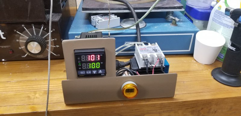

For small benchtop work, I'm running an old Neycraft. It heats VERY fast. At full tilt, Plugged into 110vt, it only hits 12amps.
I built the pid setup. Can't do this stuff without it.
