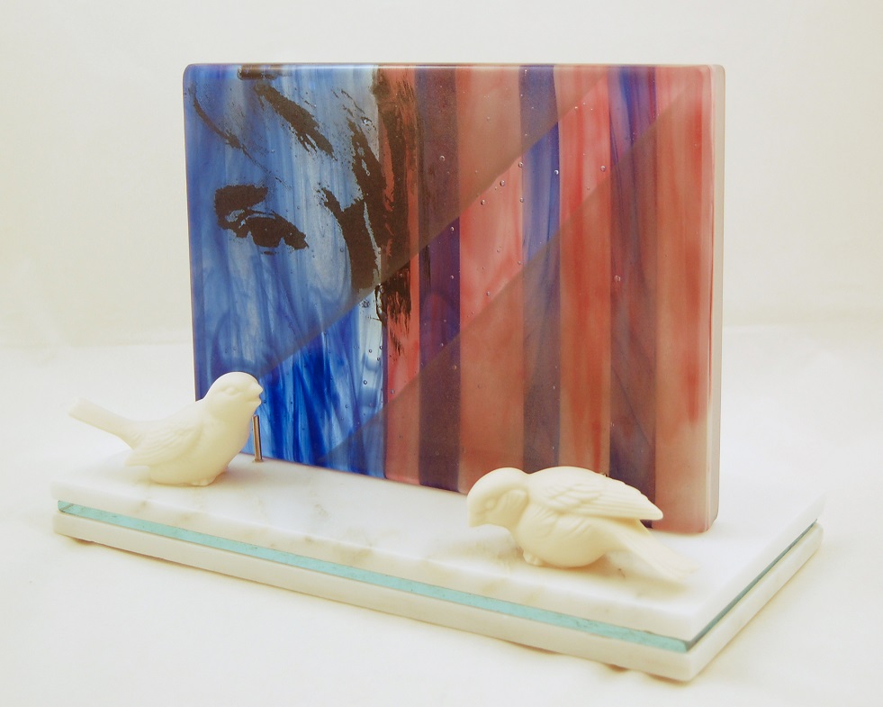

Re: Drilling holes in stone
The stand for this piece is made from two 6x12" marble tiles from Home Depot sandwiching a 6 mm piece of glass (all held together with silicone). The little posts (you can see one behind the bird on the left side of the picture) are stainless steel welding rods, cut into small pieces. There are two rods in the back and two in front keeping the glass upright, just in case someone bumps into it. The holes were drilled in only the top piece of marble, prior to the base being assembled. I let my husband drill the holes -- ever since I decided to hold a piece of unfired glass while using a hollow-core drill bit, I am a little squeamish with drills (can we say stitches in multiple fingers? :) ). We have a metal shop at work, and I had someone snip the welding rods for me. You could also use wooden dowels or I've also seen some metal pegs that I think are used for shelving which would work As for the rest of it, the birds are vintage ceramic pieces from an antique store. This piece is called Within, Without and is a tribute to someone I lost.
I hope this gives you some ideas on the stand!

Dana, Thank you. Your piece is beautiful and quite spiritual. The clear glass in between enhances the dreamy quality. BTW, I often visit your site and learn something each time.
