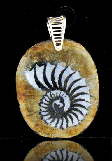

I've been drilling holes in my glass jewellery with 2mm diamond bits with a drill press for some years. Each piece usually goes through the kiln afterwards and so the edges are softened. However, I run into a issue when I want to drill pieces that cannot go back into the kiln. Inevitably there is some chipping on the edges and for these pieces I need the edges clean and chip free.
My method has been to drill the initial hole with a smaller bit and then use a diamond burr of some shape. However, these burrs are never top quality and never fine enough. The results are mixed.
I also have a rotary tool but am not familiar with all of the attachments and their uses. I'm wondering if there is something similar to that black wet or dry sandpaper that might be in a useful cone or ball shape for sanding the edges? Or if there are other suggestions. Otherwise I may just try to do it manually.
