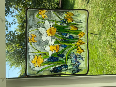

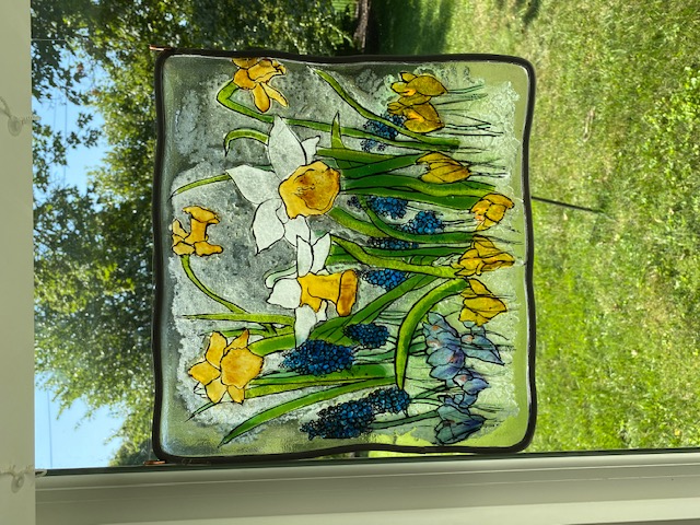

Post by Don Burt »
Fused BE colors on Tekta, silver stain and enamels. Panels for the other seasons are planned. Hence the odd hanging alignment to the left of the picture window.

Post by Don Burt »
Not sure why the embedded photo is 90 degrees rotated. When I click the image it rights itself.
