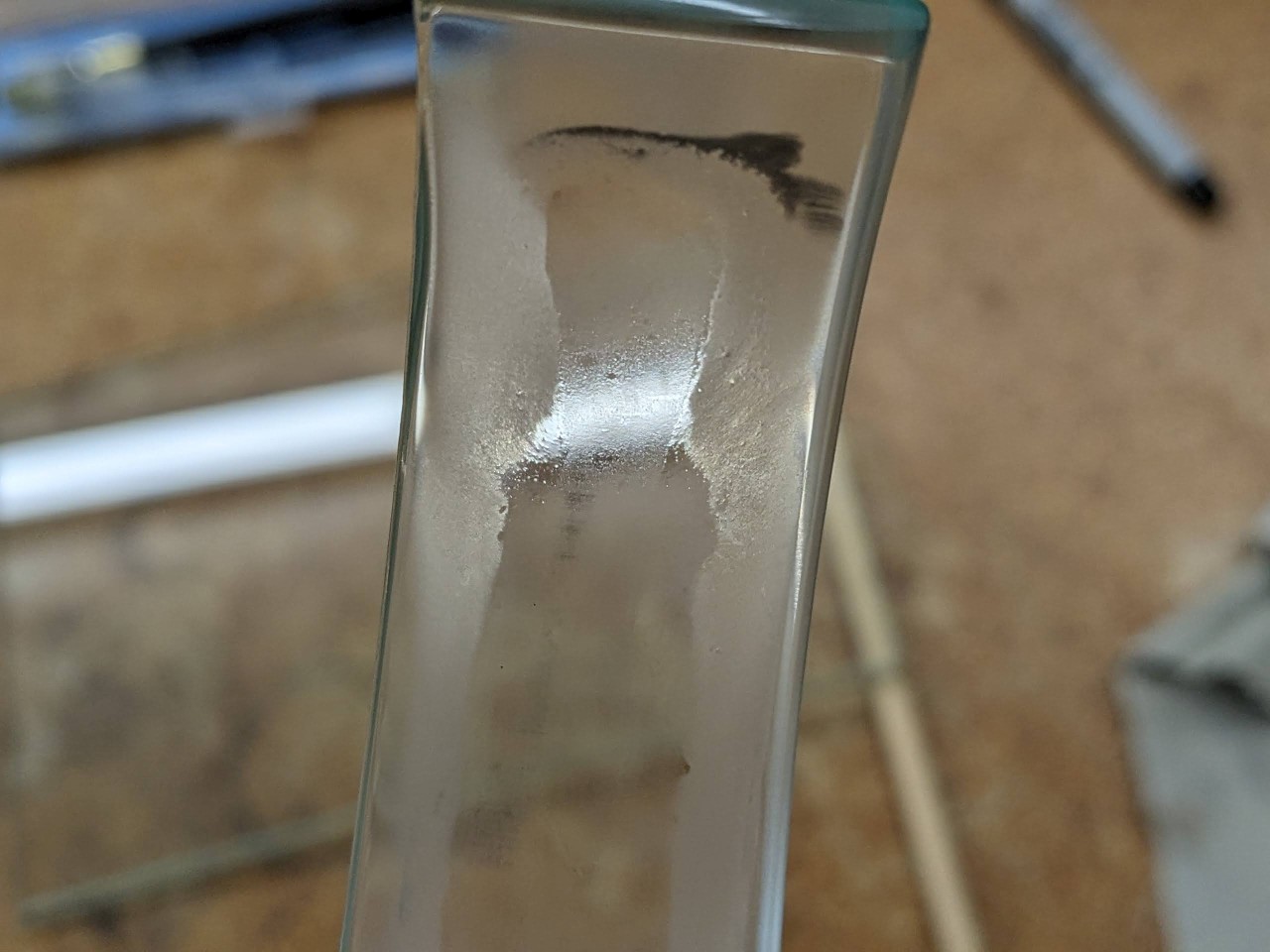

Hi all, dean here, product designer/maker totally new to glass forming.
I'm slump forming 3/16" float glass over a graphite mold, and I'd like the result to be as clear as the original glass. The glass comes out of the oven though with a hazy, somewhat rough, surface where it was supported by, or even near, the mold.
  • the mold is graphite, new, pretty darned smooth
  • no kiln wash or paper
  • 300°/hr to 1400°F, hold 40 minutes; AFAP to 900°F, hold 60 minutes; 100°/hr to 700°F; oven off.
Is it even possible to have a perfectly clear final surface where the glass contacts the mold? Any tips on how I can get closer to that ideal?
thanks!

Re: Keeping glass in contact with mold crystal clear
Post by jolly »
Only saw this now. I wouldn't use graphite in a kiln. Yes, you can shape glass without it taking on the texture of the mold. About 1200 degrees F, it should not take on the texture since it is float glass.
