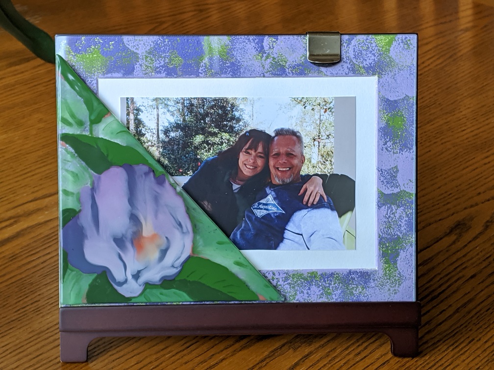

You've probably already figured this out, but I find that Color Line self-levels and flows fairly significantly.
I've been having fun with it, but I'm also planning on some experiments on how not to have it flow.

I am image challenged - the last response was supposed to include images. Anyway, before fire/after fire photos.
[img] [/img] (and now you get to see what my brother received for his birthday, after I visited him in late February... the last trip for a while, I suppose!)
